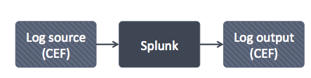

Scenario 2: CEF data does not need translation (because it started out in CEF format)
In this scenario, the logs are generated in CEF and provided to Splunk but they need to be forwarded to a device that accepts CEF. Thus, no translation is necessary. It would look something like this:
Recommended solution:
Use outputs.conf to forward the events on to the destination device. In this case, the Splunk App for CEF is unnecessary because no translation step is required since the events are already CEF events.
