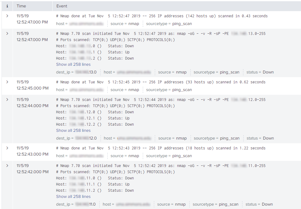

I don't believe the events are breaking correctly.
Please see the attached screenshot.

marycordova
they look like they are breaking ok, can you expand one of the 258 line ones?

This is a copy of that event:

marycordova
try the change in the regex and see if that helps
@marycordova
marycordova
Try this regex Host:\s+(?<dest_ip>[\d\.]*)\s*\((?<dest_host>\S*)\)\s+Status:\s+(?<status>[Up|Down]+)
Additionally, a sample of the events from Splunk, not just the actual nmap output, would be helpful, I wonder if your event breaking is working correctly or not.
