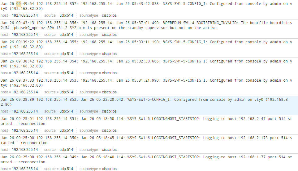

I am trying to get logs like traffic logs (allowed OR blocked), ACL logs etc from Cisco core switch, But am getting only the console logs.

I have enabled logging trap debugging, Still after doing that we should need to get all the logs right?
But after doing that also still getting the same logs which is shown in the image.

Did you do what I suggested in my answer? See the links below. You don't need debugging, you need informational, and you need to add "log" or "log-input" to the Access Control Entries (ACEs)
