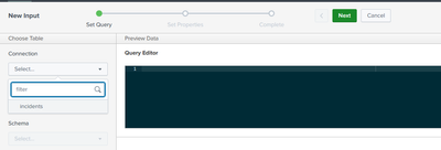

I am actually able to see the driver in the installed drivers tab, and I can see my stanza within possible connections when trying to test a query:

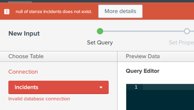

I am getting this error now:
I also see this in the logs:
2024-12-19 14:38:59.018 +0000 Trace-Id= [dw-36 - GET /api/inputs] INFO c.s.d.s.dbinput.task.DbInputCheckpointFileManager - action=init_checkpoint_file_manager working_directory=/opt/splunk/var/lib/splunk/modinputs/server/splunk_app_db_connect
2024-12-19 14:39:15.807 +0000 Trace-Id=6dac40b0-1bcc-4410-bc28-53d743136056 [dw-40 - GET /api/connections/incidents/status] WARN com.splunk.dbx.message.MessageEnum - action=initialize_resource_bundle_files error=Can't find bundle for base name Messages, locale en_US
