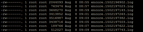

Hi,
We are running the eSteamer eNcore app with default settings but it looks like it's not able to catch up with the FMC. Currently we are receiving data with time-stamp of Aug 7th 7:53 PM. We do see the time-stamp moving forward but it's extremely slow.
Tried changing the monitor.period setting under estreamer.conf to 30 seconds and even tried 1 sec just to see what happens but eNcore log files are still generated at the interval of 120 seconds, which is the default setting app came with. Splunk has been restarted after the change but the new setting doesn't seem to take effect.
Period changed to 10 seconds:
Log monitoring frequency still @ 2 minutes:
Has anyone been able to successfully modify the default settings for this app?
Thanks,
~ Abhi

But in our case, it looks like eNcore is not even writing 10,000 lines.
[root@ data]# ls -lh
total 25M
-rw-------. 1 root root 1.7M Aug 10 09:45 encore.1502372743.log
-rw-------. 1 root root 1.4M Aug 10 09:47 encore.1502372866.log
-rw-------. 1 root root 2.9M Aug 10 09:49 encore.1502372990.log
-rw-------. 1 root root 1.1M Aug 10 09:51 encore.1502373113.log
-rw-------. 1 root root 328K Aug 10 09:54 encore.1502373237.log
-rw-------. 1 root root 252K Aug 10 09:56 encore.1502373362.log
-rw-------. 1 root root 1.1M Aug 10 09:58 encore.1502373486.log
-rw-------. 1 root root 2.4M Aug 10 10:00 encore.1502373610.log
-rw-------. 1 root root 319K Aug 10 10:02 encore.1502373733.log
-rw-------. 1 root root 319K Aug 10 10:04 encore.1502373857.log
-rw-------. 1 root root 3.6M Aug 10 10:06 encore.1502373981.log
-rw-------. 1 root root 2.2M Aug 10 10:08 encore.1502374105.log
-rw-------. 1 root root 1.3M Aug 10 10:10 encore.1502374228.log
-rw-------. 1 root root 1.3M Aug 10 10:12 encore.1502374353.log
-rw-------. 1 root root 1.2M Aug 10 10:14 encore.1502374476.log
-rw-------. 1 root root 1.2M Aug 10 10:16 encore.1502374600.log
-rw-------. 1 root root 1.3M Aug 10 10:18 encore.1502374723.log
-rw-------. 1 root root 1.2M Aug 10 10:20 encore.1502374847.log
[root@ data]#
[root@ data]# cat encore.1502374847.log | wc -l
720
 [root@ data]# cat encore.1502373981.log | wc -l
1985
I'll try disabling "Connection events" and enable logs that are less verbose but I think issue is something else.
