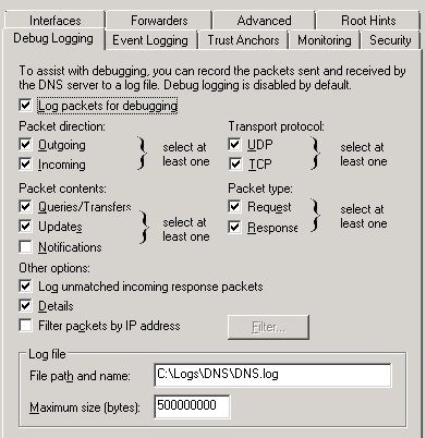

OK, I got everything working. Here's the final config:
First, on your DNS servers, enable the following buttons
DNS properties trace log config
Then, I ended up basically modifying an app initially built by a Splunk SME, @yshabano. The Folder structure is below:

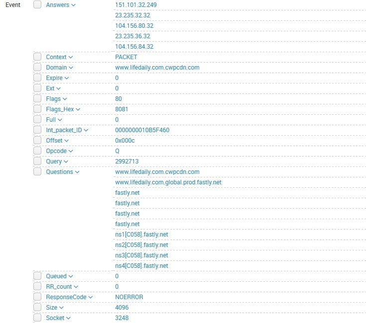

Restarted every thing and this is what you see in your search results:
Splunk search results multi values
CAVEATS:
This currently does not really parse out some things. For example, in the following event:
ANSWER SECTION:
Offset = 0x0026, RR count = 0
Name "[CC].dmeserve.newsinc.com."
TYPE CNAME .
CLASS 1
TTL 3374
DLEN 34
DATA .wildcard.newsinc.com.edgekey.net.
Offset = 0x0054, RR count = 1
Name "[C2].wildcard.newsinc.com.edgekey.net."
TYPE CNAME .
CLASS 1
TTL 16820
DLEN 21
DATA .e54.g.akamaiedge[C04F].net.
Offset = 0x0075, RR count = 2
Name "[C060].e54.g.akamaiedge[CF].net."
TYPE A .
CLASS 1
TTL 7
DLEN 4
DATA 2.56.22.17
where 'DATA' is NOT an IP address, this does not get parsed out, so the only Answer value will be the single IP of 2.56.22.17
Also, where the ANSWER section is empty:
QUESTION SECTION:
Offset = 0x000c, RR count = 0
Name ".elb0328-7098004.us-west-1.elb.amazonaws.com."
QTYPE AAAA .
QCLASS 1
ANSWER SECTION:
empty
AUTHORITY SECTION:
Offset = 0x0041, RR count = 0
Name "[C0].us-west-1.elb.amazonaws.com."
TYPE SOA .
CLASS 1
TTL 60
DLEN 70
DATA PrimaryServer: .ns-1009.awsdns-11.org.
Administrator: .awsdns-hostmaster.amazon[C8].com.
SerialNo = 1
Refresh = 7200
Retry = 900
Expire = 1209600
MinimumTTL = 60
ADDITIONAL SECTION:
Offset = 0x0093, RR count = 0
Name "."
TYPE OPT .
CLASS 4096
TTL 32768
DLEN 0
DATA
Buffer Size = 4096
Rcode Ext = 0
Rcode Full = 0
Version = 0
Flags = 80 DO
You probably will not have anything in the Questions or Answers fields.
Finally, I'm not currently parsing anything out of the AUTHORITY SECTION or the ADDITIONAL SECTION. I may add those later.
I think that's it. Happy Splunking!
