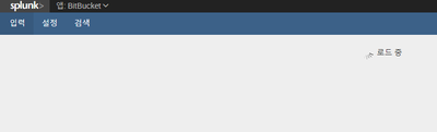

hyeji
Loves-to-Learn Lots
Adding that app will return related issues.
Unable to initialize modular input \"bitbucket_repositories\" defined in the app \"TA-bitbucket\": Introspecting scheme=bitbucket_repositories: script running failed (PID 9923 exited with code 1)..

Hello @hyeji , have you been able to evolve this issue?
I'm also having the same problem, obviously, I'm trying to run this add-on on version 9.2 of Splunk, I applied python future to the code and managed to overcome several compatibility issues between python 2 and 3, but I still couldn't run the add-on. If you have any status of this you will be very welcome.
