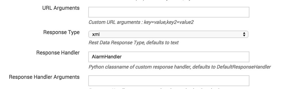

Does this look right?

ncrisler
New Member
For some reason when I added AlarmHandler to the bottom of responsehandlers it broke the polling of the REST data. Do I need to add import xml to the top of the config?

Should I just be adding this to the bottom of responsehandlers.py ?
