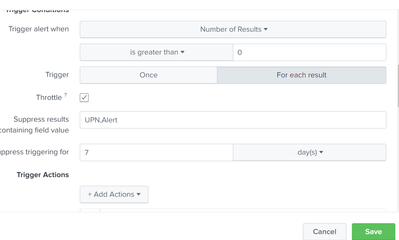

How is your alert defined? - Number of results greater than 0
I see only "status=Done" in  View Recent. I didn't see my failed alerts here.
Below is the screenshot of the alert.
isoutamo
Hi
it seems that you have added Alert Throttling here. This means that it didn't fire again same alert within Suppress triggering for time, which you have 7 days. Can this be the reason for no fire alerts?

@isoutamo I disabled the throttle now. But again the same issue persists.
When I check the index=_internal & scheduler logs it is showing the status as success. Whereas I didn't receive any alert ServiceNow/Email/MS teams.
Out of 10 alerts, I am receiving 8 alerts properly. 2 alerts always failing.
