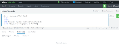

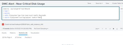

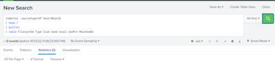

Hello @gcusello
I tried the search that you suggested but I didn't get the results
I did something wrong?
Thank you!
Hi @btmoises,
$host$ is the value of a dropdown list to choose the host to monitor, you have to use the hostname of the host to monitor:
index=os sourcetype=df host=<your_host_to_monitor>
| head 1
| multikv
| table Filesystem Type Size Used Avail UsePct MountedOnCiao.
Giuseppe

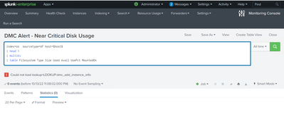

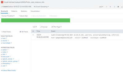

Hello
It seems that the index=os shows no data, the same with the host and sourcetype.
I use index="_*" to check all the data sources, above you can see all the sources.
So, the /dev/mapper/vg01-splunk is the $host$ right?
Thank you
Hi @btmoises,
if you installed the Splunk_TA-nix, see where you archive data, usually index=os, so use this index in the search.
If you haven't this TA, install it or find a different way to extract the disk space value.
Ciao.
Giuseppe
