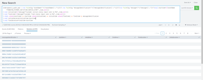

vineela
Hi Both,
   Thanks for your response.
But i am not able to get any results.
please find screenshot for reference.
ITWhisperer
Remove "stats count by eventName" - this is limiting the events to just two fields (count and eventName)
