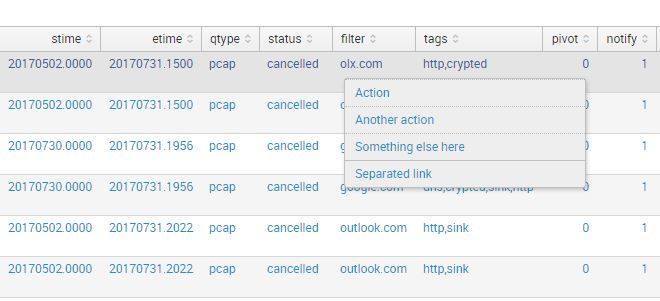

Hi Amat,
There is no documentation for Context menu creation in Splunk doc. You need to create context menu via bootstrap-contextmenu.js library.
There is nothing needs to install bootstrap. You just need to import library like <script type="text/javascript" src="path to /bootstrap-contextmenu.js"></script>. Here your dashboard XML code needs to be converted to HTML code, so that we can customize the Splunk dashboard.

@sumangala html elements can be added to Simple XML dashboard using <html> panels inside the <panel> node. Then all <html> tags can be added like <div>, <p>, <ul>, <li> etc. PS: <body> can not be added. Consider starting from <div> element as container within html panel.
sumangala
@niketnilay,
Yeah, we can add simple html tags to the xml file. But we can not link event call to html tags or some of other advance functionality. Customization of Splunk dashboard can better done in html than xml code.
niketn
Legend
@sumangala I would disagree. This kind of customization is exactly what Simple XML JS and CSS extension supports. Using the Extensions is particularly useful for keeping the dashboard as Simple XML and not to loose existing dashboard behavior as several new features like <init> section for dashboards, table cell coloring by Simple XML configuration etc are not available in html dashboards.
I have added an approach below to add context menu to Simple XML dashboard using Simple XML JS extension. However, for this particular use case that is not the right approach as Right click on table cell will not retrieve the table drilldown values to be used in context menu. Please refer to my alternate solution to use modal popup instead of context menu.

U can add context menu splunk table with the help of bootstrap library.

Click event with a context menu seems a lot of JS code to me.
Since your use case seems like user would launch to either Dashboard 1 or Dashboard 2, can you add a radio button with both dashboard names and on Chart drilldown event pass on the selected dashboard name?
basilarockiaedw
Thanks for the respone,I can achieve the functionality by adding a radio button. Just curious to know in splunk do we have an option to accommodate the context menu in drill down.
