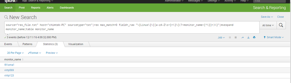

...................................|rex max_match=0 field=_raw "\[Linux\]\[[a-zA-Z\s+]+\]\[(?<monitor_name>[^\]]+)\]"|mvexpand monitor_name|table monitor_name
Look at my result
