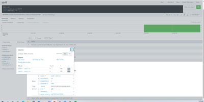

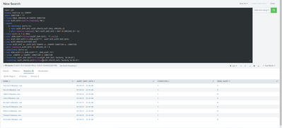

It is working for me although I have slightly different commands to you. What I don't understand is why, for example, Robert appears in the results of the search on day 2. If as your output suggests his country is not CAN, he should have been removed by the first where command. If he has been removed, ALERT_DATE is not set when he is then added back in by the append inputlookup, which means he should have been removed (again) by the third where command. Can you rerun it with the changes I have suggested so we can see some more of the field values?
longmen
Hi ITWhisperer,
Thanks for your prompt response. I implemented your logic on Splunk 8.2.1. and Robert still pops up on Day2 even though he is not flagged on Day2 csv file.  Also, no alert was sent to Robert on Day3 as well even though he is flagged on Day3.
Additionally, I implemented your logic on paid Splunk virtual environment and another dataset and I've got the same result.

ITWhisperer
What results do you get from just the first two line i.e. search + lookup?
(The results you have shown confirm that CONDITION is set to Y when we are not expecting it to be)
