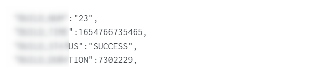

This is returned as maxThis is returned as maxThis should have been the max.This should have been the max.
5 is returned as max but the correct value should be 23.
ITWhisperer
It looks like Task_no is being treated as a string (although I have not been able to reproduce the issue with the example data you have shared).
