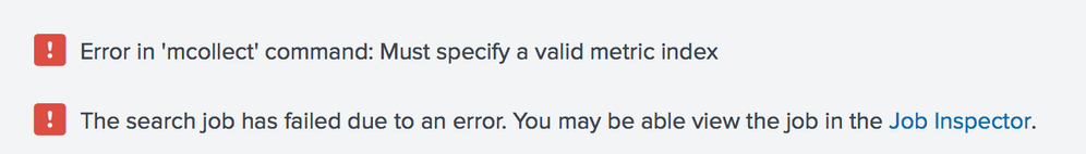

Why is my search using "mcollect" command causing the following error: "Error in 'mcollect' command: Must specify a valid metric index"?
ben_leung
Builder
In my query before, I was using the outputcsv search command, and then I had a monitoring input stanza to upload it to my metrics index.
I then took out the outputcsv command and started using mcollect.
Not sure why, but the metrics index is not valid when it recieved metrics from a different method.
....  | mcollect index=metrics-index
And on my indexes.conf, the settings is configured to be metrics:

Okay so to resolve the issue, setup the metrics index on the search head cluster.
Missing the indexes.conf on our search head cluster. Overlooked this because we have indexes defined on our indexers.
Also because the previous method of using outputcsv and a monitoring stanza did not require any index definition on search heads.

In a distributed splunk environment, the search head also needs to have stub index of the same name and datatype for any of the collect (ie. collect, mcollect, meventcollect). Note: for metric index, you will need to specify datatype = metric in the relevant index.conf stanza.
