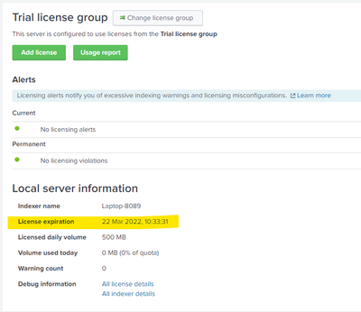

zhoayang
Engager
Hi @SanjayReddy
Sorry forget to list the snapshot. it shows the license doesn't expire.

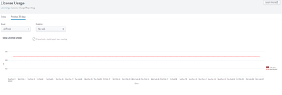

zhoayang
Engager
Hi @SanjayReddy
great!! I think it is the reason why my indexer is in violation status. I found a lot of warnings in my alert console
that said This pool has exceeded its configured poolsize=0 bytes. A warning has been recorded for all members.
Maybe I should solve this problem then I will follow your advice. appreciate It! thanks again.
zhoayang
Engager
Hi, @SanjayReddy
 Thanks for your reply. I check the expiration time and it doesn't expire now. and I also change the license group to a free license but still have the same issue.
I also have another discovery is my indexer is in violation. does it is the reason I got this issue? how to set the indexer to normal status?
thanks for your help.
