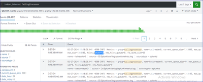

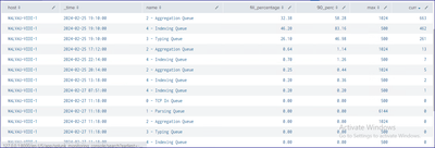

uagraw01
Motivator
@gcusello The last event to come from the _internal index was on February 27, 2024, and below is the result of your search. I am pasting it below. Could you please help me understand the issue with the queue.
gcusello
Hi @uagraw01 ,
the results mean that you have some queue but not so critical (you don't have 100%)
add to your search the host with missed logs and see if there are queues congestion on this host.
Ciao.
Giuseppe
