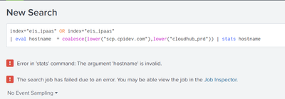

arshiarshi
Hi @gcusello ,
Thanks for your reply. But it is showing some error in the stats command, i think it is expecting something else along with stats command.

gcusello
Hi @arshiarshi,
at first, avoid to use dots in field or index names so you don't need quotes.
then don't use quotes in coalesce.
Anyway, the problem is the stats command, you should use:
| stats BY hostname
Ciao.
Giuseppe
