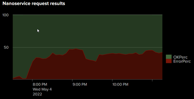

In one of my graphs I try to fixate the areacolors to red and green. However, I can't figure out how.

But the colors stay wrong. Am I doing it wrong?
Current graph:
Purple should be green and blue should be red.
Cheers,
ericvdhout
No idea what FieldColors does, but SeriesColors seems to be my friend.
		"viz_CgGpI6E0": {
			"type": "splunk.area",
			"dataSources": {
				"primary": "ds_aNB3d69r_ds_d4nLznpt"
			"title": "Nanoservice request results",
			"options": {
				"stackMode": "stacked100",
				"seriesColors": "[#42663a,#7a1709]"
			"showProgressBar": false,
			"showLastUpdated": false
