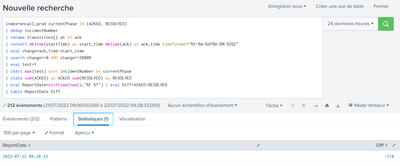

I have a problem with a comparison. I want to compare a number of acknowledgments on a number of alerts over a period of X minutes (example: the number of acknowledgments between 0 and 5 min VS the number of resolved alerts between 0 and 5 min). I use Splunk OnCall and I think I found the right search for it but I don't know why, I can't make a clean graph for it. I would like a bar with padding to indicate the delta between my acknowledged alerts and the total alerts. Here is what my search yields:
Do you know how to force display it to show the delta in question?

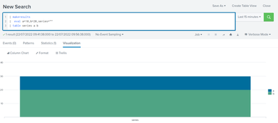

If you have just two fields, Splunk is going to graph one value against the other.
You need a third field which will work as series differentiator.
If you do just
| makeresults
| eval a=10,b=20
| table a b
And try to graph that. You'll get yourself a nice little rectangle like you did with your search.
But if you leave the _time field
| makeresults
| eval a=10,b=20
| table _time a b
 Or even create some phony field on your own
| makeresults
| eval a=10,b=20,series=""
| table series a b
You can now go to visualization, chose column chart with proper stacking and will get something like this:
Notice however, that the values are stacked so if one is 10 and the other is 20 they add up to the "big bar" which has a height of 30. You'd have to do some substraction to make it add up to the bigger value but I'm sure you'll manage that 😉

Hi @somesoni2, thank you very much for your help and research. Here is the result :
The info is interesting because it displays the delta directly with the generation date, I think to use it for a report instead.
However, in my case, I need both infos (ACKED VS RESOLVED) for my dashboard and it's the display that gives me problem because I can't make a cumulative display (something like this):
Do you know what is wrong with my search to display this kind of graph?

Hi @PickleRick,
Thank you for your solution, it's exactly what I needed, and with the little subtraction that goes well, I have exactly the result I want.
Thanks also to @ITWhisperer who agrees with the same idea of ​​better managing fields.
I learned a lot about this problem, thanks again.
Best regards,
Rajaion
ITWhisperer
Short answer - Remove the last 3 lines
Longer answer - the two bars in your graphic would be represented as two series in the chart; each series is effectively a different field or column in the statistics table; the chart command you already have in your search gives you these fields / columns, you just need to visualise them and format to use stacked columns.
