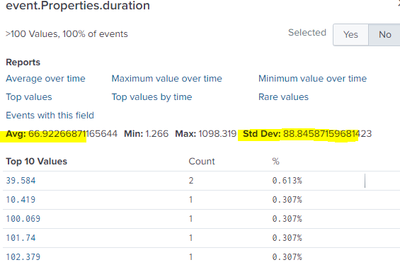

Hi
Can anyoine suggest me how to create Avg & Std Dev graph from the fields

Hi Kendall
yes i tried that, stil not getting any output
KendallW
Contributor
Add a space between  the two timechart functions. E.g.
| timechart avg(event.Properties.duration) stdev(event.Properties.duration)
Also, you can remove the
| iplocation
 as we aren't using any of the fields that command adds for this visualization, so it will only slow down the search.

Hi @jaibalaraman,
You can calculate the mean and standard deviation using the stats command:
| stats avg(event.Properties.duration) as u stdev(event.Properties.duration) as s
however, that won't produce a chart.
At a glance, your data is not normally distributed. You can generate a simple histogram with the chart command:
| chart count over event.Properties.duration span=31
If you have Splunk Machine Learning Toolkit installed, you can use the histogram macro and visualization:
| `histogram("event.Properties.duration", 31)`
Note that the histogram macro uses the bin command:
bin "$var$" bins=$bins$ | stats count by "$var$" | makecontinuous "$var$" | fillnull count
It won't necessarily honor your bin count.
What type of graph or visualization would you like to create?
