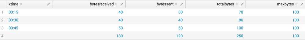

Hi,
There's probably a couple of ways to do this, depending on how you want to output to look at the end.
One option is using appendpipe and stats as a replacement to addcoltotals (which is what I'm guessing you're using).
Here's an example (you can ignore the makeresults and append stuff, the first 7 lines, that's just to simulate your data):
| makeresults count=1
| eval bytessent=30 | eval bytesreceived=40 | eval xtime="00:15"
| append [| makeresults count=1
| eval bytessent=40 | eval bytesreceived=40 | eval xtime="00:30"]
| eval bytessent=50 | eval bytesreceived=50 | eval xtime="00:45"]
| fields - _time
| eval totalbytes=bytessent+bytesreceived
| eventstats max(totalbytes) as maxbytes
| appendpipe [| stats sum(bytesreceived) as bytesreceived sum(bytessent) as bytessent sum(totalbytes) as totalbytes max(maxbytes) as maxbytes]
| table xtime bytesreceived bytessent totalbytes maxbytes
This would give a table that looks like this:
As you mentioned eventstats, it sounds like you were already 90% of the way there anyway.
I hope that gets you closer to what you're looking for.
Graham.
