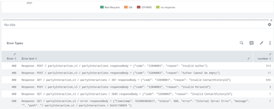

Extract data between curly brackets
Digvijay
I want to extract data between 2 curly brackets {} from below ErrorText string

Digvijay
@venkatasri  thank you so much .Perfect solution😊
