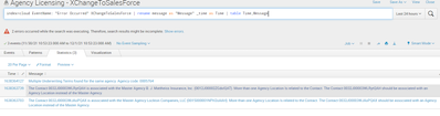

I have splunk search - index=cloud EventName: "Error Occurred" XChangeToSalesForce | rename message as "Message" _time as Time | table Time,Message
When i search on splunk search, i get the below response

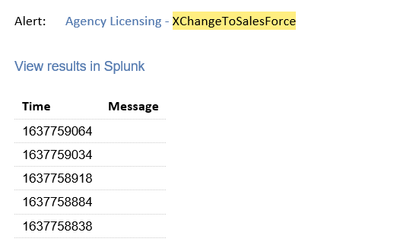

1637759064  Multiple Terms found for the same agency. Agency code:
But when the email is sent, i get nothing on the message field
Time
Message
1637759064

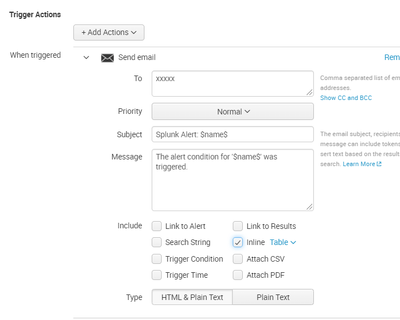

How is the email formatted? Are you inserting the results as an inline table?

@johnhuang  it is formatted as inline table, i tried inline raw as well

@johnhuang  any idea why it is skipping the Messages

Could you post a sample of the search result and also the email template config.

This is the search and I am getting the desired result here. But when Email is sent the Message field blanks out
