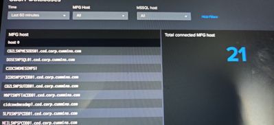

 i want add Radio button in which i want setting that when i will select MFG host it will show all MFG host result and when i will select MSSQL host it will show only MSSQl result and hide the MFG host result. Please help out for this setting

Hello,
I understand you have two dropdown boxes;
1.  MFG hosts (default all,  I assume behind the scenes you have a query that provides the list of the hosts that are MFG related.  I assume you have a query likewise for the MQSQL dropdown.
Then the Panel has the MSG hosts.  I really can't see going through work to try to hide unhide panels.  Depending on the querys used and if you can attach a sample source for the dashboard would help.
I would recommend the following approach:
if a single search that can be run to list all hosts both mysql/msg with a flag where you can set a variable say host_type or something.  then you could do a dropy down with static values for MSG and MySql set a variable $host_type$ .  Then the host dropdown has static all and will then filter to either MSG or Mysql based in where host_type=$host_type$
Then your panel would simply be called Hosts,  and same clause to list out any matching data using same type of filter where cluase host_type=$host_type$ to do something more.
I have shy'd away of doing radio buttons; and stick to drop down as layouts just don't look clean.
Hope this helps; if can post the source maybe can work it up and get you solved.
