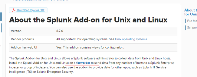

Thank you for responding.  The release notes of the TA says it needs to be put on a forwarder.  But DS is a full Splunk Ent install.  Should we still install in the DS then ?  Alternatively, would configuring the local inputs.conf of the /opt/splunk/etc/system/local directory on DS by adding monitor stanzas also work ?

Splunk Enterprise server can forward data: https://docs.splunk.com/Documentation/Splunk/9.0.0/Forwarding/Aboutforwardingandreceivingdata#:~:tex....
Best practice is for your custom inputs is in a separate addon - example: /opt/splunk/etc/apps/my_custom_app/local/inputs.conf
