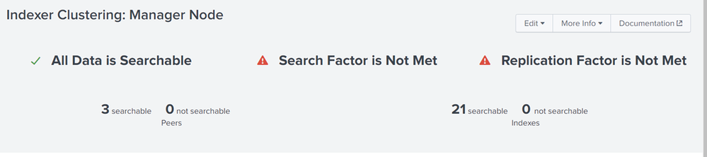

I added a new indexer to cluster, after that  tryed to change the RF and SF, both to 3, but when i change the values from splunk web in the master node and restart the instance, th aplatform show me the nex message:

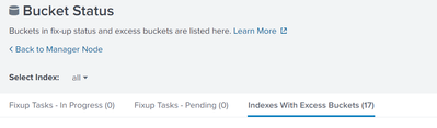

then, I did rollabck, return SF=2 and RF=2, and evetrything normal, but the bucket status shows

It may take some time for third indexer get replicated copies from other indexers and make them searchable. Did you wait enough time for this operations to finish? It is normal your search and replication factors are not met because cluster has only two copies of some buckets while migration. You could monitor this process on Bucket Status page. You should have seen a lot of pending buckets. Cluster would be a complete state after these fix-ups completed.
After rollback to RF=2 and SF=2 excess buckets are normal because cluster manager was trying to replicate buckets to match RF=3, SF=3 state, when you rollback these third copies became excess. If you want to keep RF=2, SF=2 you can simply/safely remove excess bucket from Bucket Status page.
Setting RF and SF equal to indexer count is not a best practice. Because if any of your indexers experience problem or restart your cluster will not be able to reach complete state because missing enough peers.
I advise keeping RF=2 and SF=2 with 3 indexers.

Then,  is it normal that the RF and SF appears like "is Not MeT" untill finish to replicate the buckets?, thus, the master node would show "Search Factor is Met" and " Replication Factor is Met". that is correct? besides, you advise to me apply  RF=2 and SF=3, but the replication Factor cannot be less than Search Factor.
