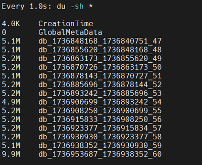

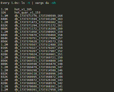

My friend and I have the same indexes.conf, but why are the bucket sizes being created different? Mine is around 1MB, but my friend's are created in 5.x MB units..

The maxDataSize for your hot buckets is 1 MB. Your friend's setting appears to be higher (5 MB).
To add to what's already been written, you're writing (compressed) data at different rates:
Friend: ~720 bytes per second
You: ~19 bytes per second
This will influence the size of the warm bucket after it rolls from hot when either maxDataSize (1 MB in your case) or the default maxHotSpanSecs value of 90 days has been exceeded.

One reason for small bucket can be source events which contains events which have time stamps from past and future. Basically those haven't continuous increasing timestamps.
When I look those smaller buckets there seem to be this kind of behavior based on those epoch times in bucket names.

My configuration has not changed.
I have verified that buckets are being created, and I have verified that a hot_quar_v1 bucket is being created. Why is it being created and how do I remove it?
