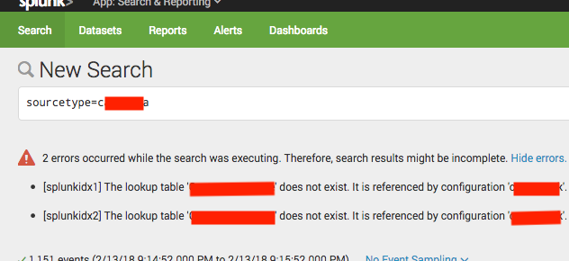

It just started happening right after the upgrade from 6.3.0 to 6.6.3. And the lookup configuration for ABC is correct and working fine before the upgrade.
I've checked the suggestions and checklist in the links but to no avail,
https://answers.splunk.com/answers/154326/so-many-lookups-so-many-errors-the-lookup-table-xxx-does-n...
https://answers.splunk.com/answers/97917/the-lookup-table-nix-action-lookup-does-not-exist-it-is-ref...
There is nothing wrong in configuration transforms.conf, it is the same as the others and it just started to happen after the upgrade.
Find the screenshot below;

Search.log shows strange error suggesting that lookup filename is not recognized and going to implicit filename.
This could have been worked around by matching the lookup name and its file name.
---> Search.log under dispatch/"SID" ---
02-12-2018 06:00:05.056 INFO SearchProcessor - Building search filter
02-12-2018 06:00:05.059 WARN LookupOperator - Unable to find property=filename for lookup=ABC will attempt to use implicit filename.
02-12-2018 06:00:05.059 WARN LookupOperator - No valid lookup found for lookup=ABC
This is just for an immediate workaround. To root cause it please contact splunk support with DEBUG enabled diag, which is taken after a repro - make sure to provide SID.
