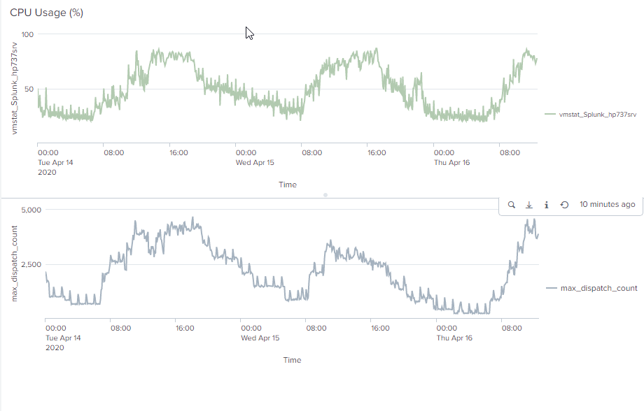

We are suffering form High CPU on a one box set up of Splunk (about 54 cores index and search head all in one). As the issue is complex, i want to know will more hardware help or do we need to do other changes?
We have build a system where we have saved searches that call saved search (Like Java function). We have done this as we use the same core function for alerts and dashboards so we have the same code line.
However this seems to have the impact of increasing the number of jobs dispatch (splunk/var/run/splunk/dispatch).
For example if you call one saved search you are putting 2 jobs into dispatch directory. If you call a lookuptable that is also another jobb etc.. before we know it we have 5,000 jobs! This causes high CPU
We have put in place scripts to remove these jobs(Non Running jobs) per minutes every minute but still it grows very fast during busy periods, this has an impact of having high CPU. The graph shows the CPU on top and the number of directories in the splunk/var/run/splunk/dispatch. We can see they are closely correlated.

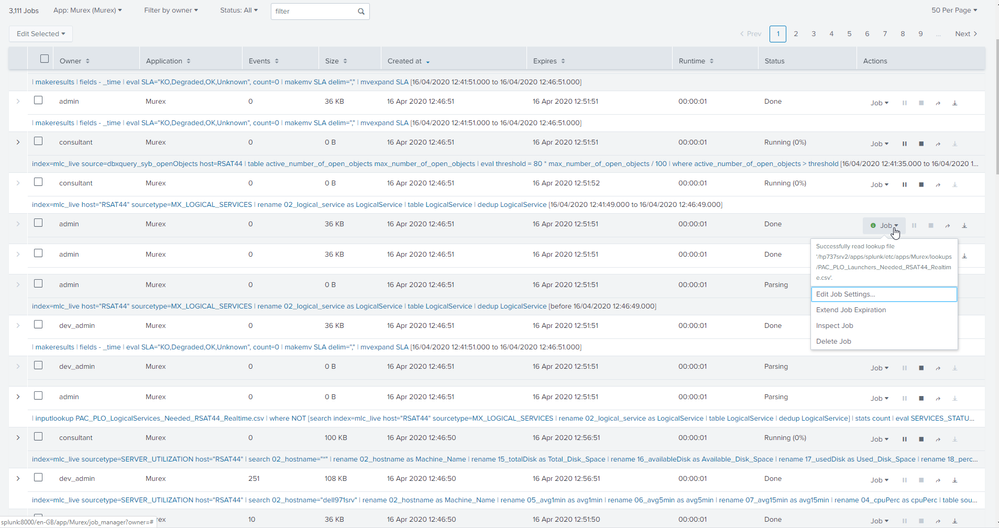

We can see form the running jobs that we have a lot of blank jobs - i think they are the lookuptables etc..
But they are also taking a lot of jobs -
