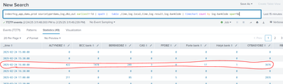

I have xml messages in search. row like this
<log><local_time>2025-02-25T15:02:59:955059+05:00</local_time><bik>ATYNKZKA</bik><fileName>stmt_3110449968.pdf</fileName><size>555468</size><iin>800716350670</iin><agrementNumber>3110449968</agrementNumber><agrementDate>08.11.2011</agrementDate><referenceId>HKBRZA0000388473</referenceId><bankCode>ALTYNDBZ</bankCode><result>OK</result></log>
<log><local_time>2025-02-25T15:02:59:885557+05:00</local_time><bik>ATYNKZKA</bik><fileName>stmt_dbz.pdf</fileName><size>152868</size><iin>840625302683</iin><agrementNumber>4301961740</agrementNumber><agrementDate>21.06.2023</agrementDate><referenceId>HKBRZA0000388476</referenceId><bankCode>ALTYNDBZ</bankCode><result>OK</result></log>
 I see after search in field in '_time' and 'log.local_time' date time with seconds and parts. Seems to be OK
But when i try build timechart i see next
Seems to be timechart don't know about minutes and seconds. And know only hours. My span=5m is ignored.
For me it is ok using _time or log.local_time
I try various method parse with strptime but useless
thanks

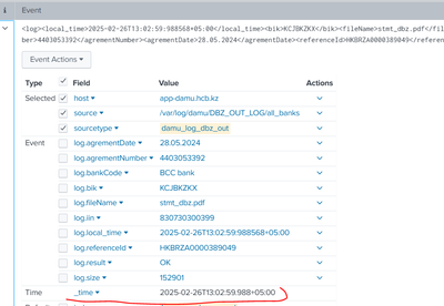

I see time in ROW like this
I have search with another sourcetype. _time format is the same/
And similar timechart is OK spreading with span =5 min  work OK
Dontknoooooww 😞

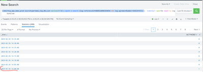

Ok i get find only one xml event
search it  index=hcg_app_damu_prod sourcetype=damu_log_dbz_out earliest=-1d | spath | search (log.referenceId=HKBRZA0000389094 AND log.agrementNumber=4303291972)
And then i build timechart
So event with _time =2025-02-26T14:02:59.970+05:00
Goes to bucket at 2025-02-26 14:00:00
Im sure my events spread on 5 minutes buckets
I have no Idea why it go to hour bucket's
ITWhisperer
Again, this event appears to be in the right bucket. Please provide evidence that you have events in the wrong buckets, otherwise, this seems to be a non-problem 😎
