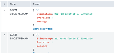

Screenshot 2021-08-04 at 9.15.21 PM.pngScreenshot 2021-08-04 at 9.15.21 PM.png

Hi @kamlesh_vaghela ,
thank you so much for your answer. But it does not work. I was thinking if it can't be below issue/solution. (I am collecting it via HTTP Event Collector)
Solved: HEC: How to set _time on base of a specific JSON f... - Splunk Community
But my SEDCMD works correctly and I was able to remove "log": property from events, hence the props.conf in HF has to work correctly and its not case of the "event" end point of HEC.
Also SEDCMD is only thing which works.
SEDCMD-RemoveLogProp = s/("log":)(.*)(?="stream":)//
Could it be that INDEXED_EXCTRACTION is OFF and KV_MODE is ON in search?
Thank you very much.
