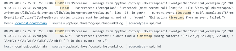

I try to generate events with replay mode, but it is not working properly. All timestamp is same. Of course original sample file is time series data, which means each event has different timestamp.

After restart splunk, I could see this view. Generated events have same timestamp.
What I have to do? What wrong with this?

It must be extracting timestamp issue. But It's correct! 😞 Could anyone please let me know what's wrong?
