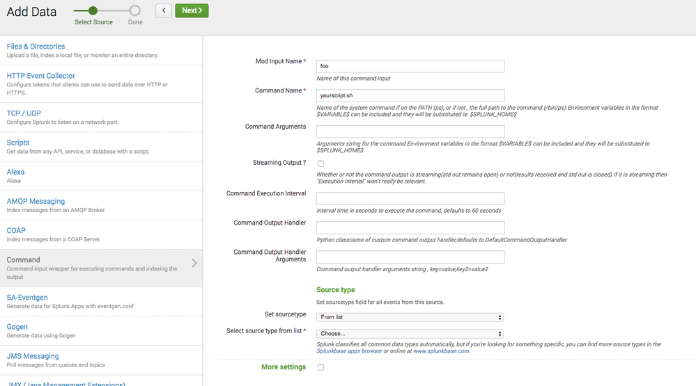

Simple :
Wire up your script using the Command Modular Input
https://splunkbase.splunk.com/app/1553/
Of course you can also refactor your script into a Splunk Scripted Input or Modular Input and deploy it in it's own App , but if you simply want to execute your script as is and capture the STDOUT in Splunk , then the Command Modular Input will work. And has some advanced stuff like plugging in your own preprocessing if you want.
