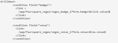

Basically we have a search results with 5 columns and 10 rows containing random numbers on each cell and the requirement to is click into one of the numbers in the cells and open a new tab to another search or lookup file.   According to the Splunk Answer thread there's an option or variable for $row.column_one$, $row.column_two$, $row.column_three$... that can be used.  Here's snippet of the thread:
Is this true/correct?    How do we set or call these variables to point to a specific row.column.number for the $click.value$ ?     Is this based on or using a <condition> ?

Thanks again for the response.  After reviewing the link to the documentation, it does not (or at least from reading it) the documentation did not include specific situations of having or using <condition> statement i.e. field="Network"> for a specific cell and depending on the cell selected/clicked, drilling down in to it and running another search or going to a lookup file.
Here's a screenshot of the example from the documentation:
We've tried setting the token to one column heading name with no luck so far.     As a test we tried defining or setting the token as one cell or $row.col1_PKIenabled$ in this case "col1_Network" is the same field generated/used by the stats command or "mySearch | stats count as "col1_Network".
