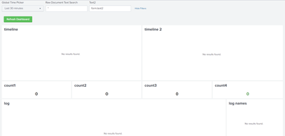

I tried your settings but all searches send "no result found" :
here is the source code :

and when I open the search I got this :
index=test sourcetype=test_st * form.text2 | stats first(env) as env earliest(_time) as startsAt first(TxName) as TxName count(Id) as Count by Id | eval startsAt=strftime(startsAt, "%d-%m-%Y %H:%M:%S.%3Q") | sort -startsAt
What I did wrong ?

index=main * form.text2 and no result again
gcusello
Hi @mah,
the initial value for text2 is missing.
Please try again.
Giuseppe
mah
Builder
Yes sorry I added it and nothing change.
What I found out is it seems to work only with _internal index, I tried with another index like :
index=main * form.text2 and no result again.
And it works with _internal index because the string "form.text2" appears in _internal logs due to my multiple searches !
Try to your side with another index you will see and tell me if you have same issue please.
gcusello
Hi @mah,
using wineventlog is running in my Splunk.
Ciao.
Giuseppe
mah
Builder
OK @gcusello
I understand what happened : when I save the code, the text "form.text2" appears in the input field :
I removed the text and pressed enter and now the input text2 is cleared and results appeared.
The drilldown works perfectly.
In my final dashboard, I removed the input text1, to see how it's behave, and one input do the job.
Thanks for your patience !
I will vote for the post with the right code.
