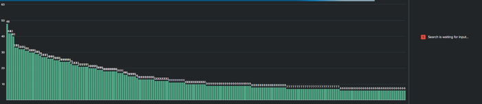

I am trying to configure two panels in a single row where one panel is 85% and the other is 15%.  I already have the style set up to accomplish the following:
I would like to hide the right panel and have it appear when I click a bar on the right.  That would mean the bar graph would start across the entire row then slide to the right to reveal the right panel at 15%.
I have tried multiple configuration but cant seem to get it to work properly.  When I click on the bar graph it seems to split the row at 50% however, the it does show the table at 15%.
The code I am working with is below.  I have tried different combinations of the id tags but still cannot get it to work.

rkeq0515
I am curious of the purpose of the percent sign at the end of the token variable?
width:$width_change$%
rkeq0515
Thanks for this.  I took your suggestion and modified to fit what I wanted.  This seems to work for me.
