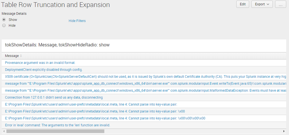

If you want to have an option to switch between truncated message and complete message you can try something based off the following run anywhere example implemented using Simple XML.
When Message is truncated using Hide Details(default behavior):
When the complete Message is displayed with scrollbar using Show Details option:
Following is the Simple XML run anywhere code based on Splunk's _internal index for your reference:

Please try out and confirm whether one of the options above i.e. Tooltip or Show/Hide details option will suffice your needs.
