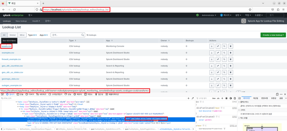

rain
Engager
For testing, I did a clean install of Splunk enterprise v9.0.5 as a docker image, and got the same results.
After the initial installation, I logged in with admin // password and installed the splunk-app-for-lookup-file-editing_401.tgz
- btool results
sudo /opt/splunk/bin/splunk btool web list --debug | grep root
/opt/splunk/etc/system/local/web.conf root_endpoint = /splunk
- screenshot of test instance
burwell
hi @rain Thanks for the very thorough testing and screenshot.
So I looked at my test instance and actually I do see what you are seeing when you hover over a lookup: the root endpoint "/splunk" is not there BUT when I click on the csv in the lookup editor, I am able to edit the lookup.
Did you try to edit a lookup? I don't get an error at all and things do seem to work.
