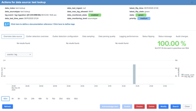

I believe indeed the from approach with Elastic Sources would comply with the requirements, I haven't much the chance to document it and what would be the requirements, however I believe something like this would be a good start:
In this example, the lookup has an _time field, there are some concepts which of course are not relevant for a lookup like ingestion level metrics, however if the lookup has an _time field then it is possible to monitor the "event lag" naturally:
With a few evolutions, I could design TrackMe to fully address the use case, if you wanna tell me more about yours feel free to do so, otherwise I will start to look at it.
