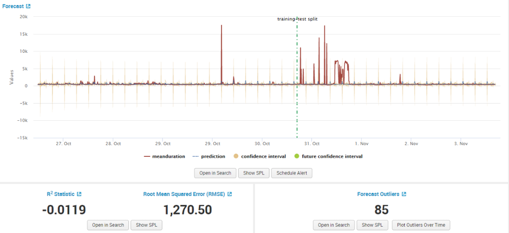

During the development of a project, we faced some problems concerning the output of correlation coefficient R^2, when using the Splunk Machine Learning Toolkit version 3.1.0.
About the results concerning the regression coefficient, when evaluating the performance of a fitted time series, as described here below, we obtain a negative R^2.

Hello @diasna1 - here is how we actually calculate the R^2 value as of MLTK 3.2.0:
| rename "$a$" as _actual, "$p$" as _predicted
| eventstats avg(_actual) as _avgActual
| eval _actualMinusAvg = _actual - _avgActual, _residual = _actual - _predicted
| stats sumsq(_actualMinusAvg) as _sumsqActualMinusAvg, sumsq(_residual) as _sumsqResidual, count(_residual) as _sampleCount
| eval rSquared = round(1 - _sumsqResidual / _sumsqActualMinusAvg, 4), RMSE = round(sqrt(_sumsqResidual / _sampleCount), 2)
| table rSquared RMSE
Please feel free to review the similar definition on wikipedia, and let me know if I made a mistake.
https://en.wikipedia.org/wiki/Coefficient_of_determination#Definitions
So to answer your question directly, R^2 can ben negative whenever SSR is greater than SST.
Additionally, you may find this cross validated question & answer relevant: https://stats.stackexchange.com/a/12991/78566
