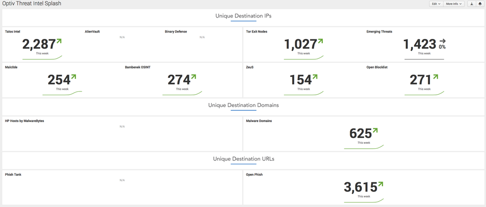

Well I guess a picture says more than a thousand words, so I will try to show you the problem.
As you Malc0de and Emerging Threats get populated. The others have an N/A.

Dev here. I am getting the same thing. AlienVault changed something with their feed. I am working on a new release to address some issues. In the meantime, try this:
Open optiv_threat_lists.py
Go to line 817
Comment out the line specified.
raw_threatlist = getUrl(urlList[4].strip('\n'),'true')
#if len(str(raw_threatlist)) > 3:
    #parseAlienVault(raw_threatlist)
^^^^^Put a hash mark in front of parseAlienVault
Restart splunk. Just tested it and it fixed the issue for me.

Thank you very much. This did indeed help 🐵
As you can see, it now populates most fields. Off course the AlienVault isn't working. Strangely enough the Binary Defence isn't, but I'll give the splunk search a look.
