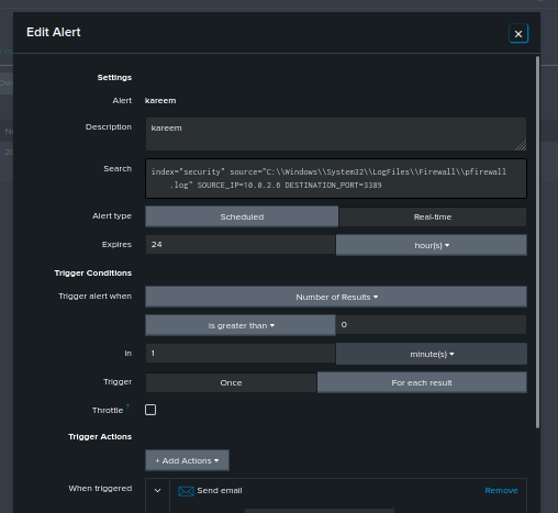

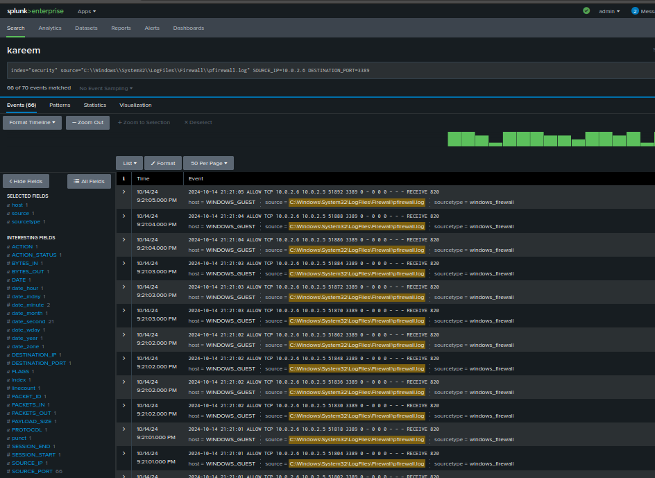

my alert is not triggered even with many matching events here are the details:
Screenshot from 2024-10-14 21-21-27.pngScreenshot from 2024-10-14 21-21-27.pngScreenshot from 2024-10-14 21-28-28.pngScreenshot from 2024-10-14 21-28-28.png
while the activity that generate these logs is running the real time alert is processing and found those events in the screenshot. i have waited for 5 mins and same issue
i have also tries scheduled and still the same issue no triggering

and here i have tried the scheduled alert and here is the logs related to that alert:
log 1:
10-14-2024 22:16:01.088 +0400 INFO SavedSplunker - AlertNotifier::notifySearchCompleted: called for sid=scheduler__kareem__search__kareem_at_1728929760_35, condition=1
log 2:
10-14-2024 22:16:01.809 +0400 INFO SavedSplunker - savedsearch_id="nobody;search;kareem", search_type="scheduled", search_streaming=0, user="kareem", app="search", savedsearch_name="kareem", priority=default, status=success, digest_mode=1, durable_cursor=0, scheduled_time=1728929760, window_time=0, dispatch_time=1728929760, run_time=0.178, result_count=1531, alert_actions="email", sid="scheduler__kareem__search__kareem_at_1728929760_35", suppressed=0, action_time_ms=718, thread_id="AlertNotifierWorker-0", workload_pool=""
